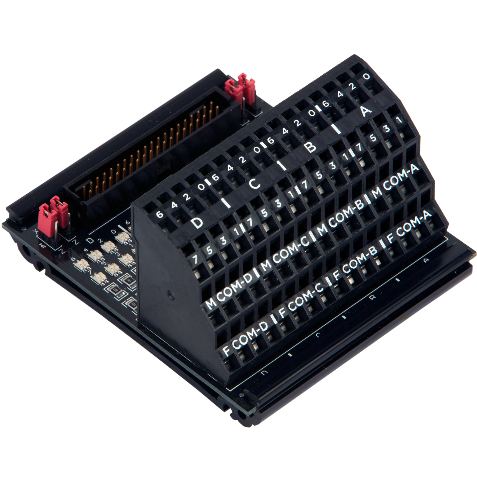

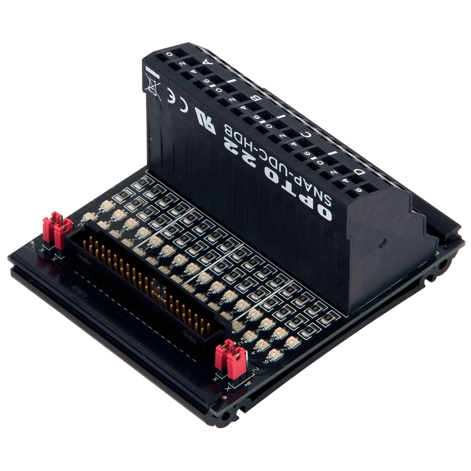

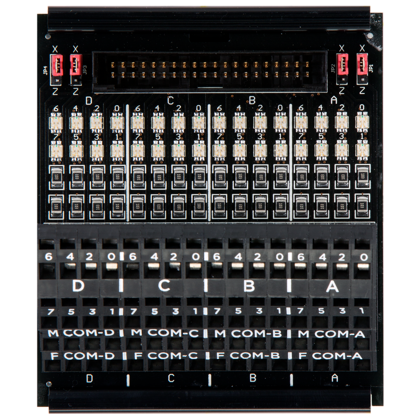

The small-footprint SNAP-UDC-HDB breakout board consolidates wiring for a 32-point SNAP high-density digital (HDD) I/O module into a small area.
Its universal design means the SNAP-UDC-HDB can be used with either SNAP 32-point input modules (like the SNAP-IDC-32) or SNAP 32-point output modules (such as the SNAP-ODC-32-SNK or SNAP-ODC-32-SRC).
This breakout board is ideal for tight locations. To save space, it does not provide fuses. Spring-clamp wiring connectors make wiring the board faster and simpler.
Connect the SNAP 32-point module to the board using a SNAP-HD-BF6 cable.
If you need a breakout board with fuses, see the SNAP-IDC-HDB (for inputs) or the SNAP-ODC-HDB (for outputs).
SNAP-UDC-HDB Breakout Rack for High-Density Digital Input and Output Modules
Used with SNAP-IDC-32, SNAP-IDC-32-FM SNAP-IDC-32N, SNAP-IDC-32D, SNAP-IDC-32DN SNAP-ODC-32-SNK, SNAP-ODC-32-SNK-FM SNAP-ODC-32-SRC, SNAP-ODC-32-SRC-FM
Connectors 40-pin header connects to 32-point module using SNAP-HD-BF6 cable.

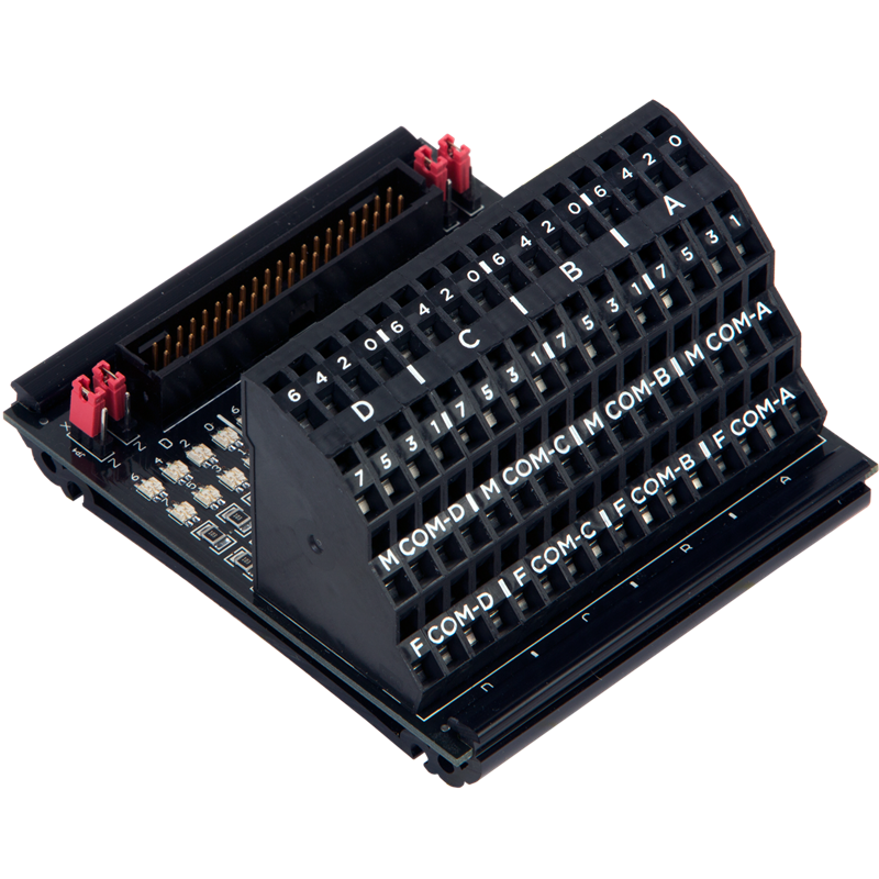

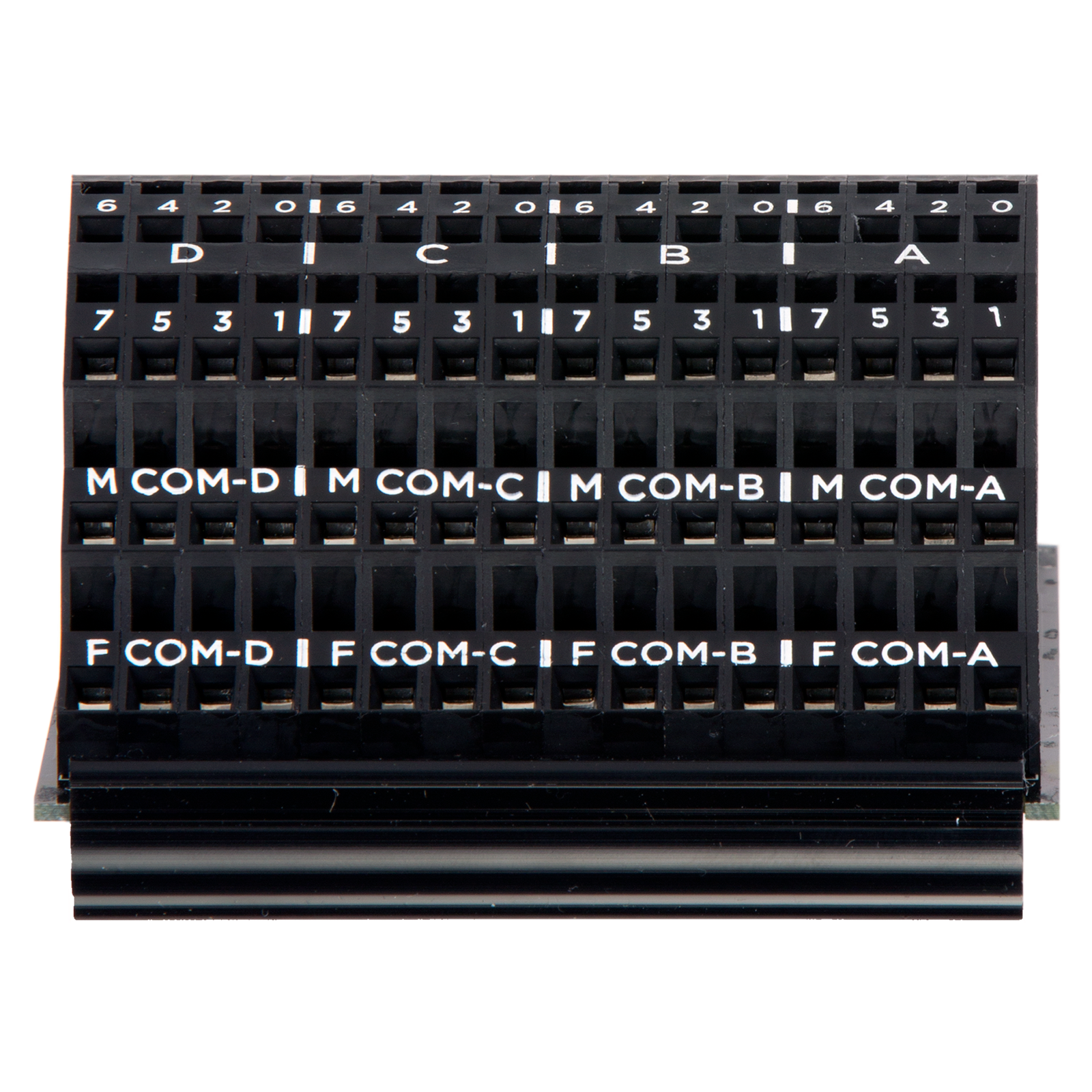

64 spring-clamp terminal block provides 1 connection for each of 32 channels, 4 connections per 8-channel zone for field common, and 4 connections per 8-channel zone for module common.
Wire size Field connector: 12-28 AWG
Indicators 1 LED status indicator for each point (32 LEDs total)
Jumpers When using any SNAP-IDC-32 input module, install all four jumpers (JP1-JP4) in X positions.
When using any SNAP-ODC-32 output module, install all four jumpers in Z positions.
