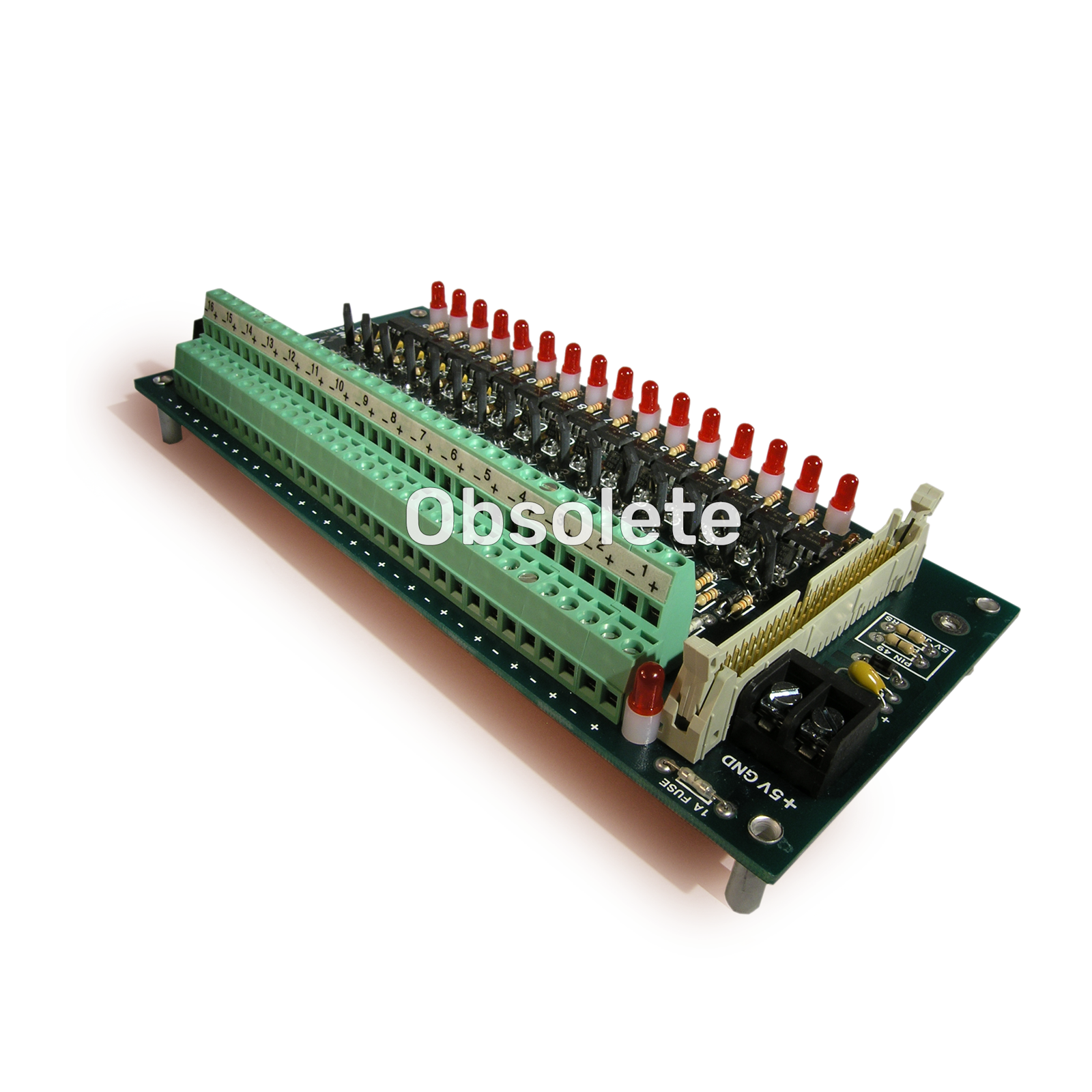

PB16L
PB16L
OBSOLETE DC Output 5-60 VDC 16-channel Integral Rack
*** The PB16L is obsolete and no longer available as of August 2012, due to the unavailability of essential parts.***
Instead of the integrated I/O, you can use the appropriate PB16 rack and the I/O modules you need. For example, you could use either of these: Note that you have additional flexibility with these racks, because they accommodate not just the 5-60 VDC output modules listed above, but also a variety of other modules.

The PB16L DC Output Rack provides 16 individual channels of optically-isolated output for controlling or switching small DC loads.
