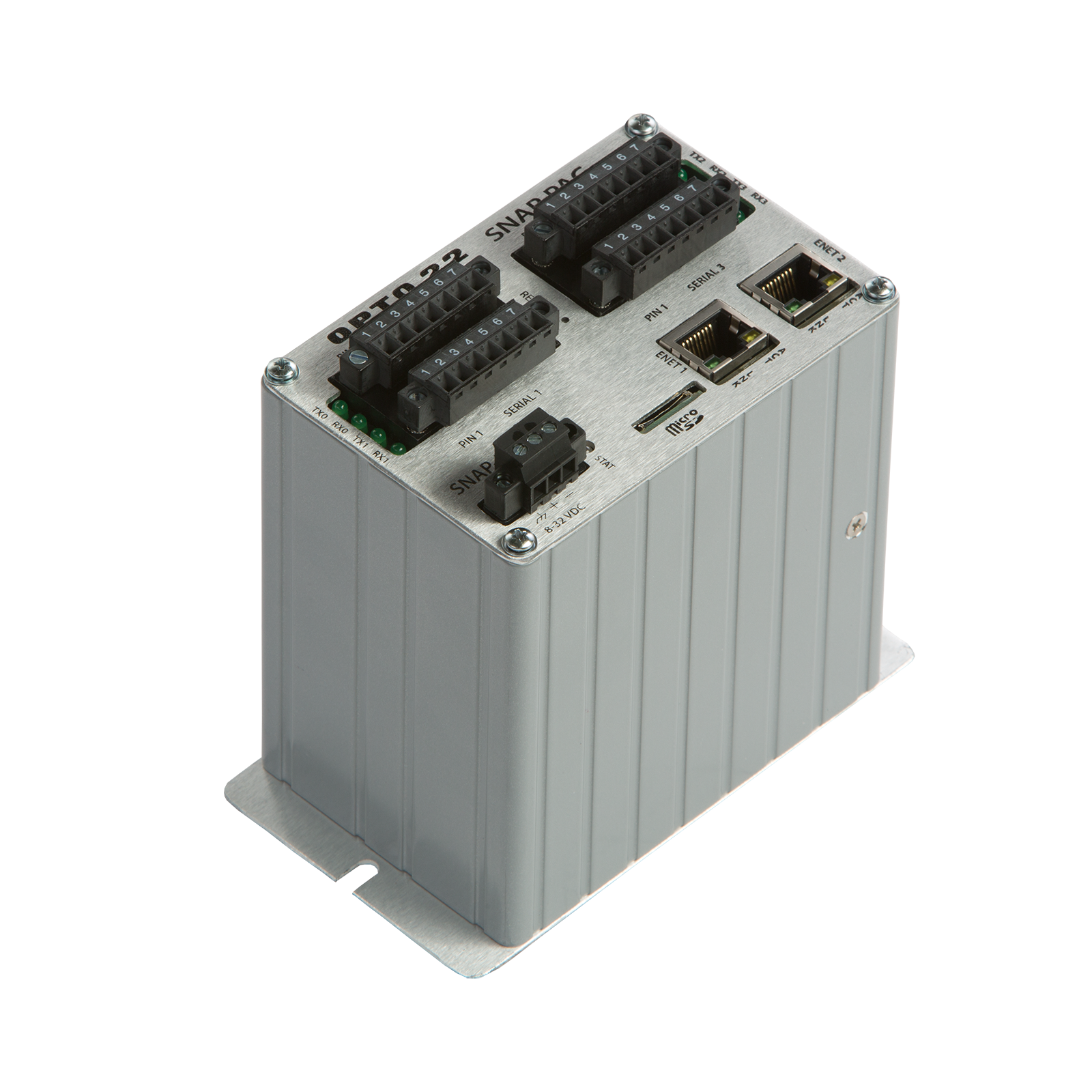

SNAP PAC S-series Programmable Automation Controller with Four Serial Ports
Now developer and IoT ready with a built-in HTTP/HTTPS server and RESTful API. See Programming below.
The SNAP-PAC-S2 programmable automation controller provides powerful, real-time control and communications to meet your industrial control, monitoring, and data acquisition needs.
Part of Opto 22's S-series family of industrial controllers, the SNAP-PAC-S2 is compatible with groov EPIC. You can control groov EPIC I/O units with a SNAP PAC S-series controller running PAC Control R10.a or higher. The SNAP-PAC-S2 is fully integrated with PAC Project software, SNAP PAC I/O processors, and SNAP I/O modules to form a complete control system. The SNAP PAC System includes digital and analog control, serial string handling, PID loops, and enterprise connectivity.

The controller is compact and industrially hardened. It includes two independent Ethernet network interfaces with separate IP addresses, which can be used to segment the control network from the company network or for redundant Ethernet network links.

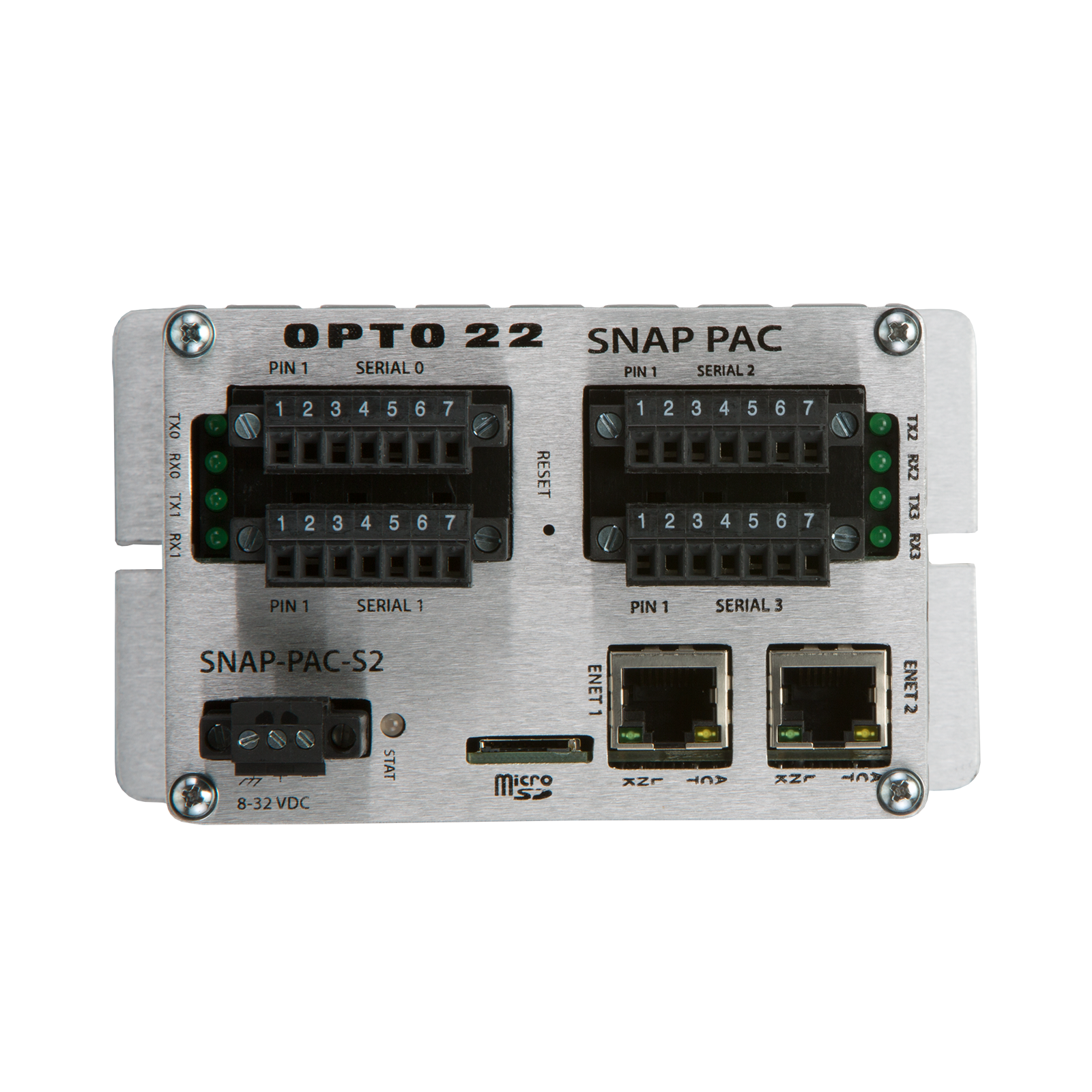

The SNAP-PAC-S2 controller is well suited for use with serial-based I/O units and serial devices. The SNAP-PAC-S2 has four serial ports that can be individually configured as either RS-232 or RS-485 (2-wire or 4-wire). Configured as RS-232, serial ports support serial device communication or a Point-to-Point Protocol (PPP) modem connection for creating a TCP/IP network over PSTN (Public Switched Telephone Network) lines. Configured as RS-485, serial ports connect to SNAP PAC Serial brains or to legacy Opto 22 mistic™ I/O units, including the serial B3000 brain and remote mistic bricks. (Note: If you are using the S2 with mistic I/O units, use the legacy user's guides versions of PAC Control (form 1710), PAC Display (form 1712), and PAC Manager (form 1714).

The SNAP-PAC-S2 can be panel or DIN-rail mounted. For DIN rail, see the SNAP-S2DIN DIN-rail mounting kit.

Two independent 10/100 Mbps Ethernet network interfaces (RJ-45 connec­tors). Each interface has a separate IP address (separate subnet). Connects to host (maximum 31 connections to port 22001; host performance may deteriorate near maximum) and I/O (maximum 15 connections to port 2001). Supports Auto MDI-X (crossover cable not needed).

Four serial ports that can be used as general purpose ports or for serial I/O units; each port is software configurable as either RS-232 (Tx, Rx, COM, DTR, DCD, RTS, CTS) or as RS-485 (2-wire, 4-wire, optional termination, optional biasing); optional mistic signal interrupts. Buffer size: 512 bytes each for RX and TX.
