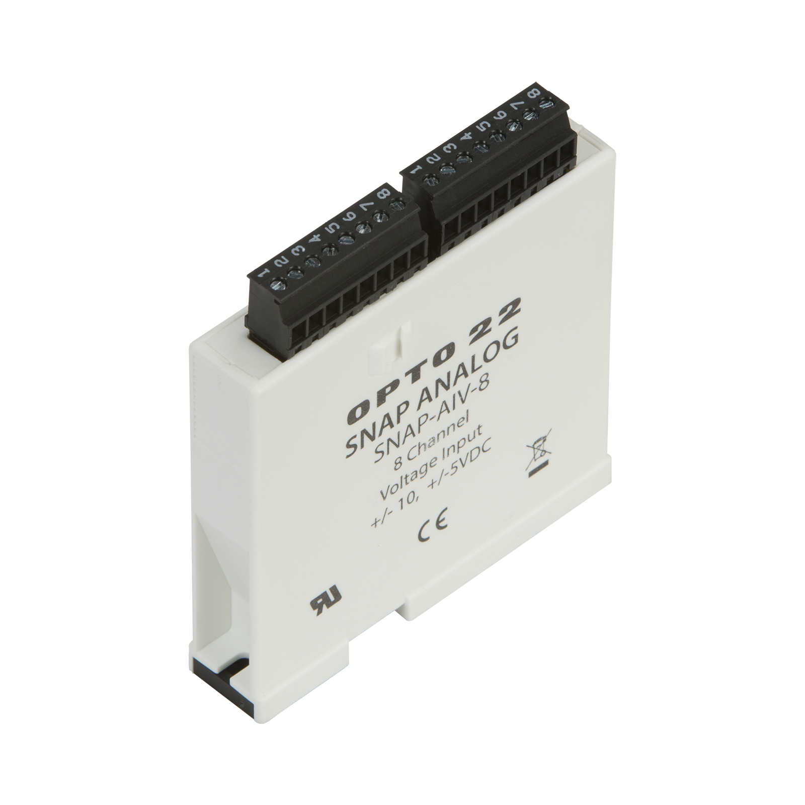

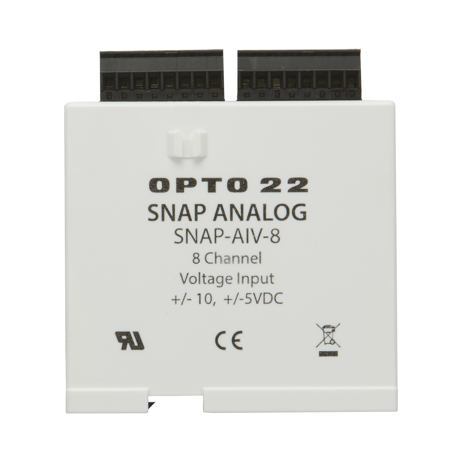

SNAP 8-Ch -10VDC to +10VDC Analog Input Module

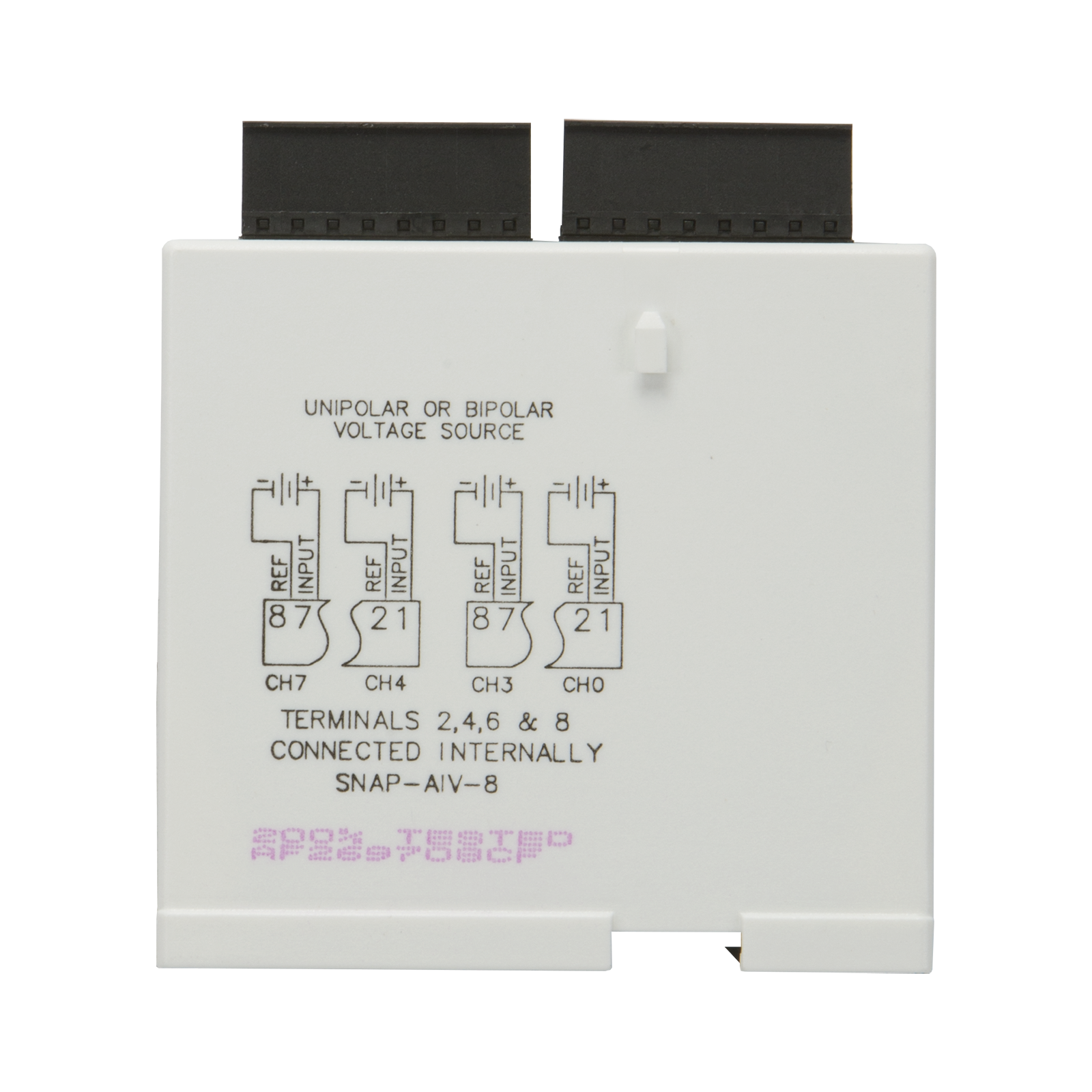

The SNAP-AIV-8 provides eight channels of analog voltage input. Each channel can be configured for -10 to +10 VDC or -5 to +5 VDC operation. Although the eight channels are not isolated from each other, the module is transformer isolated and optically isolated from other modules and devices.
Compatibility: This module can be used only with SNAP PAC controllers and brains.
NOTE: This module does not provide channel-to-channel isolation. If you need an isolated module, see the two-channel SNAP-AIV-i module.
