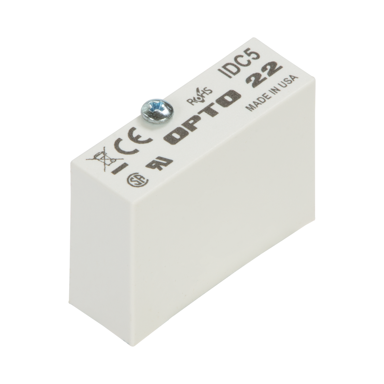

IDC5
$32.00 (USA and Canada only)
G1 DC or AC Digital Input, 10-32 VDC or 12-32 VAC, 5 VDC Logic
The IDC5 can act as either a DC or AC input, accepting 10-32 VDC or 12-32 VAC. All AC and DC input modules have a bridge-rectifier input. Each module provides up to 4000 volts (transient) of optical isolation between the field inputs and the output side of the circuit.
