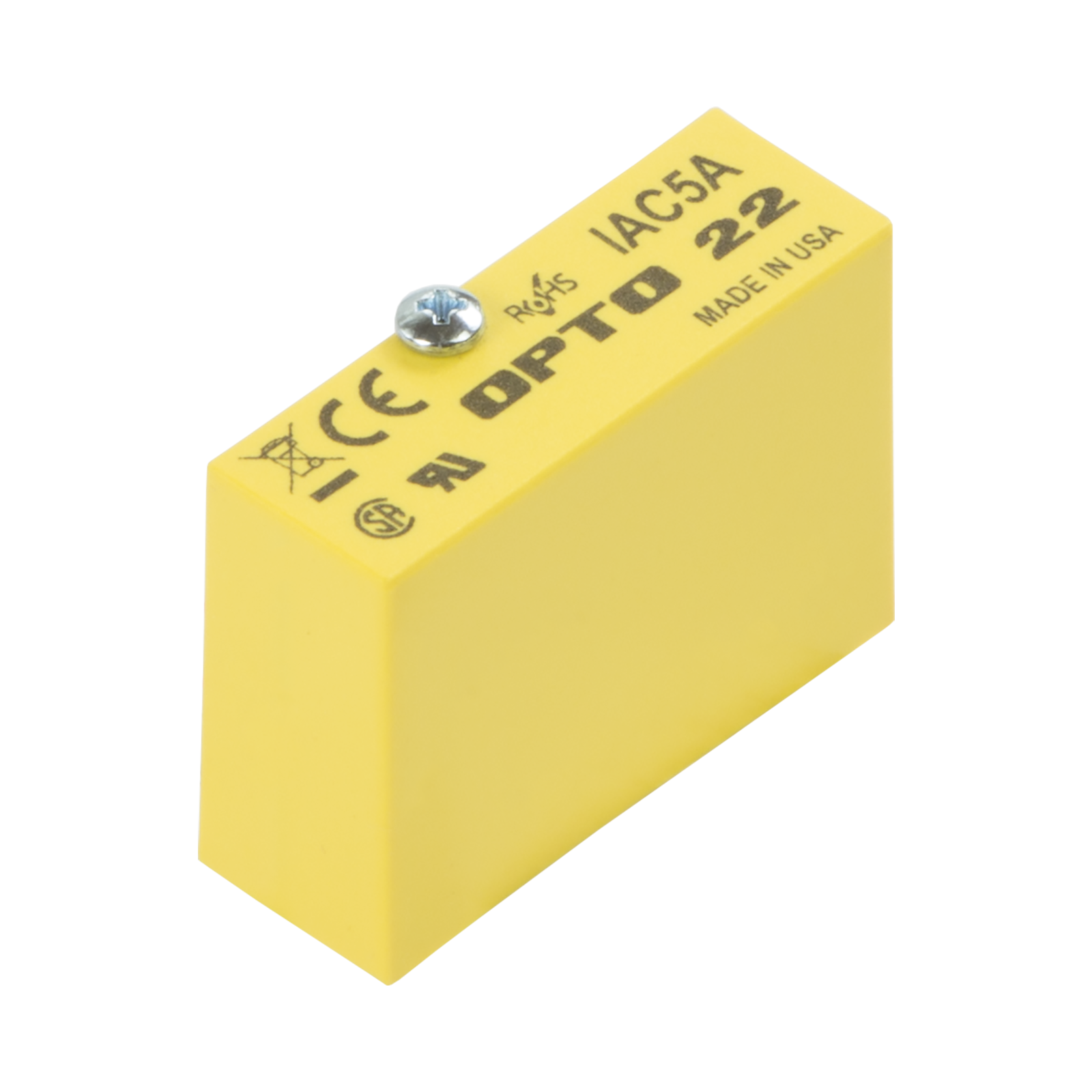

G1 AC Digital Input, 180-280 VAC, 5 VDC Logic
G1 I/O Family
The IAC5 input module is used to sense ON/OFF AC voltage levels at 180-280 VAC. All AC input modules are designed with filtering on the input and a hysteresis amplifier for high noise rejection and transient-free clean switching. Each module provides up to 4000 volts (transient) of optical isolation between the field inputs and the logic output of the circuit.
