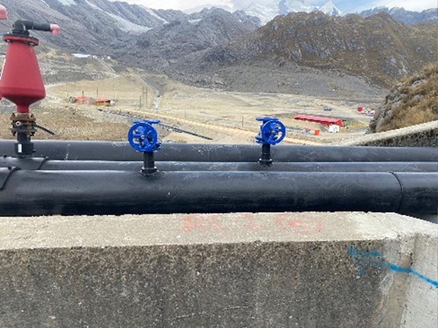

In Peru’s mining regions, tailings pipelines carry a slurry of water, crushed rock, and trace chemicals from processing plants to distant storage ponds. When a pipeline leaks, production stops instantly and costs spike, often $10,000 to $15,000 lost every half hour, plus cleanup and environmental risk.
New national regulations now require continuous monitoring of these pipelines to prevent spills and document safe operation. Mines must prove they can detect leaks in real time, not just react after the damage is done.
Across the country, operators began searching for practical ways to meet the new standards without replacing their existing control systems. For one remote site, where pipelines run for kilometers through steep mountain terrain, the goal was simple but urgent: stop leaks before they stop production.
Pipelines in Peru's mining regions

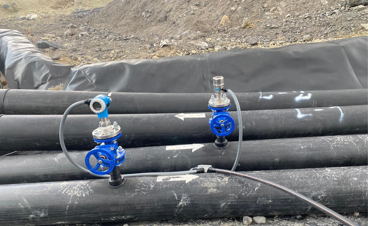

Finding the Signal in the Pressure
For PK, the answer started with pressure. Changes in pressure along a pipeline can reveal leaks long before they’re visible in the field. A small drop between two points might indicate a developing crack; a sharp drop could mean a rupture. By measuring pressure at several points along each line, operators could not only confirm a leak but also locate where it was happening.
“Pressure tells you the truth faster than anything else in the system,” says Lazo. “It reacts instantly—the first sign that something’s wrong—so it became the foundation for our monitoring strategy.”
Measuring pipeline pressure is the foundation of PK's monitoring strategy.

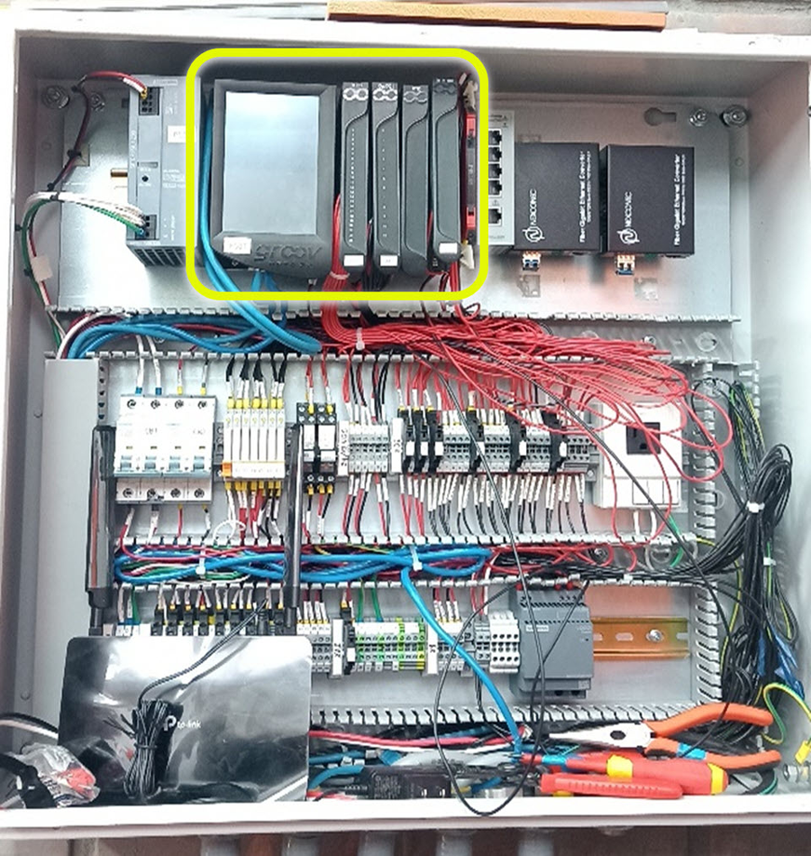

To meet those requirements, PK needed a controller that could think for itself, rugged enough for the mine site, yet flexible enough to run analytics and modern control software side by side. After testing a few alternatives, the team found what they were looking for in Opto 22’s groov EPIC® (Edge Programmable Industrial Controller).
“We wanted everything in one place—control, visualization, and analytics,” says Lazo. “groov EPIC gave us that without extra PCs or middleware, and it could handle every protocol we needed right out of the box.”
Installed at the main pumping station, groov EPIC serves as the system’s central node, polling pressure transmitters along the pipelines through a mix of wired and wireless links. The controller uses CODESYS®, an IEC 61131-3 PLC programming platform with built-in drivers that communicate with Modbus®/TCP gateways and EtherNet/IP™ variable frequency drives, gathering real-time data for local processing.
Selected tags are also logged to the site’s OSIsoft® PI historian, giving engineers a continuous record of pipeline conditions for analysis and reporting.
PK Soluciones chose Opto 22's groov EPIC as the center of their solution.

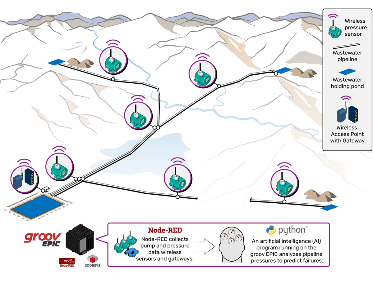

While CODESYS manages the control logic and I/O, Node-RED, a free flowchart-based IoT development platform included with the groov EPIC, handles data manipulation and short-term trending. Operators access live dashboards through groov View (an HMI development and runtime tool, also included), which displays pressure by segment, calculates differences between measurement points, and raises alarms when patterns suggest a developing leak.
Using Node-RED, CODESYS, and an AI program running on the groov EPIC enabled advanced pressure monitoring for the miles of pipeline.

Each of the two tailings pipelines is divided into four monitoring points. At the far end near the deposition area, wired pressure transmitters send continuous readings to the control network. Upstream, where terrain makes cabling difficult, Yokogawa® wireless transmitters expose data through field gateways using Modbus/TCP.
At the pumping station, the groov EPIC polls all transmitters once per second, calculates pressure differences between each pair of sensors, and detects anomalies. Node-RED builds short-term trends operators can view in real time, while OSIsoft PI logs long-term data for compliance and performance analysis.
The Python inference model runs directly on groov EPIC's Yocto Linux environment, analyzing the last several minutes of pressure data to spot early leak signatures. If a segment’s pressure delta or anomaly score exceeds its threshold, the controller triggers alarms in groov View and energizes a beacon in the pump control room. Operators can immediately see which pipeline and segment are affected.

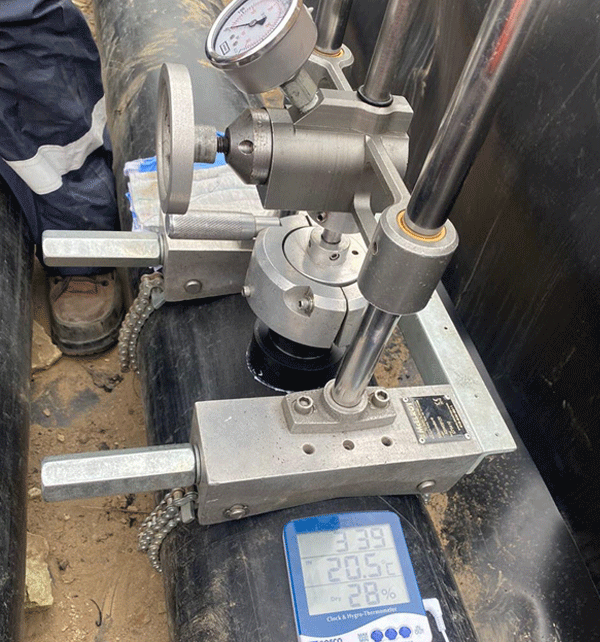

Taking pipeline measurements
Validating pipeline measurements

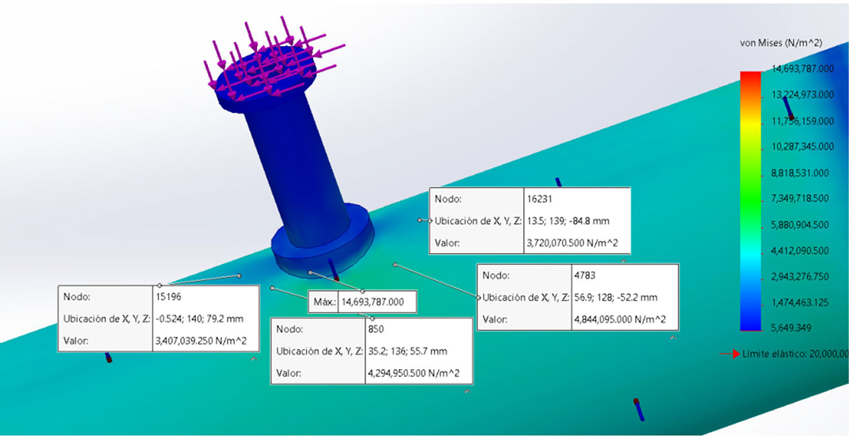

A 3D model of a pressure measurement tool on the pipeline from the AI inference model software PK Soluciones runs on the groov EPIC Linux OS
