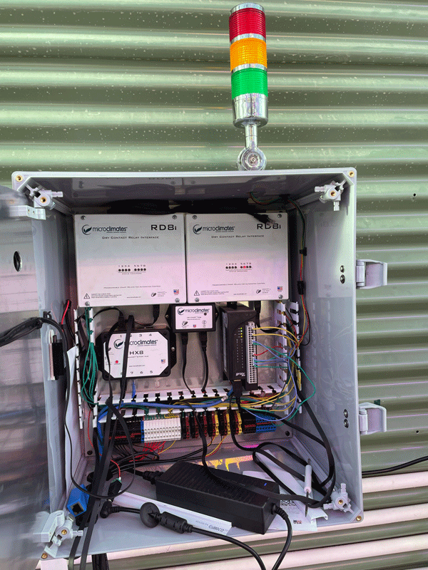

For ACE, Microclimates recommended a combination of existing and new third-party sensors, connected to Opto 22 groov RIO remote I/O modules, either by direct wiring or via Modbus through a serial-to-USB converter connected to the RIO’s USB port. Sonic sensors on a 4-20 mA circuit, for example, are wired directly into the groov RIO software-configurable I/O channels. The industrially hardened groov RIO, in addition to remote I/O connections, offers features designed for IIoT applications, including cybersecurity, power over Ethernet (PoE), several OT and IT protocols, and the ability to run programs loaded to its Linux OS via secure shell access (SSH).
Using SSH, Microclimates installs their software on the groov RIOs along with development tools including Prometheus for a database, Grafana for visualization and dashboarding, and Loki for logging. This software all runs at the edge on multiple RIOs to handle climate sensing, liquid sensing and electroconductivity (EC), and valve control.
Loren West, Microclimates Software Architect, says, “The RIOs are all PoE powered. They’re connected to the sensors that measure pH, dissolved oxygen, temperatures, water level, humidity, and so on.” In addition, power sensors monitor all power.
Brian Cook, Lethbridge Research Technologist, worked closely with Loren to design and install the system. “The level of service was the most decisive factor in choosing Microclimates,” says Brian. “Also the ease of installation. We just plugged the sensors and RIOs in and let them go. We had no issues. We were up and running within a day or so, unlike other systems. And they’re reliable.”

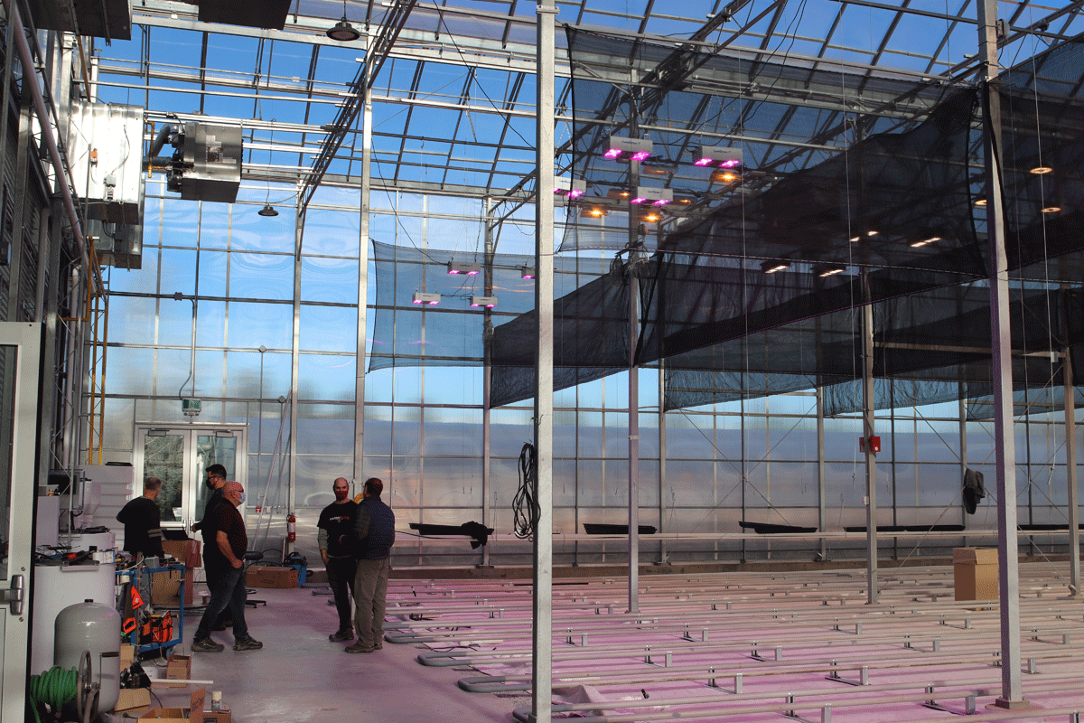

The Aquaculture Centre of Excellence greenhouse under construction
The ability to configure I/O in software was also an important feature for Brian. One sensor runs on resistance, for example, and he could configure the channels easily using just a web browser.

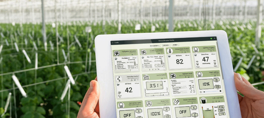

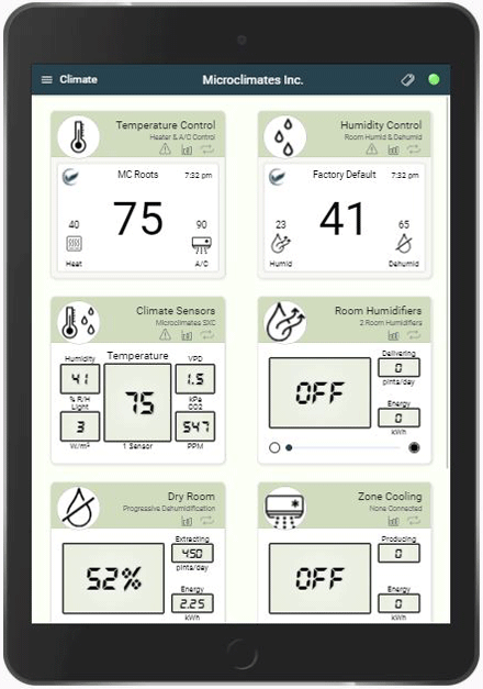

The Microclimates software collects data, shows trends, and makes decisions, for example to control valves. At present, researchers do not require historical data. It will become important in future studies, but currently they use real-time data to determine how things are working, so they can change settings for research purposes.

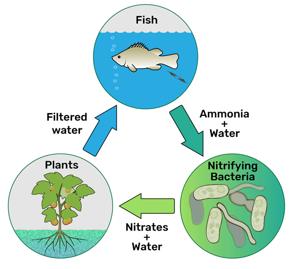

Aquaponics and more
In addition to ongoing research on aquaponics, the Centre is now working toward no-waste agriculture. Their new bioreactor system, also monitored and controlled by Microclimates and Opto 22 groov RIOs, employs aerobic reactors to take solid organic waste—fish, pig, and chicken manure, for example—and convert it to fertilizer.

In addition, the greenhouse is divided into 18 cells. “This allows us to conduct six experiments with three repeats or three experiments with six repeats, or several other combinations,” says Brian, with all experiments controlled by the Microclimates system. The researchers find daily graphs extremely useful for making small adjustments on a daily basis, for example increasing watering time to improve efficiency and plant health. Graphs also show any power failures and their results.
