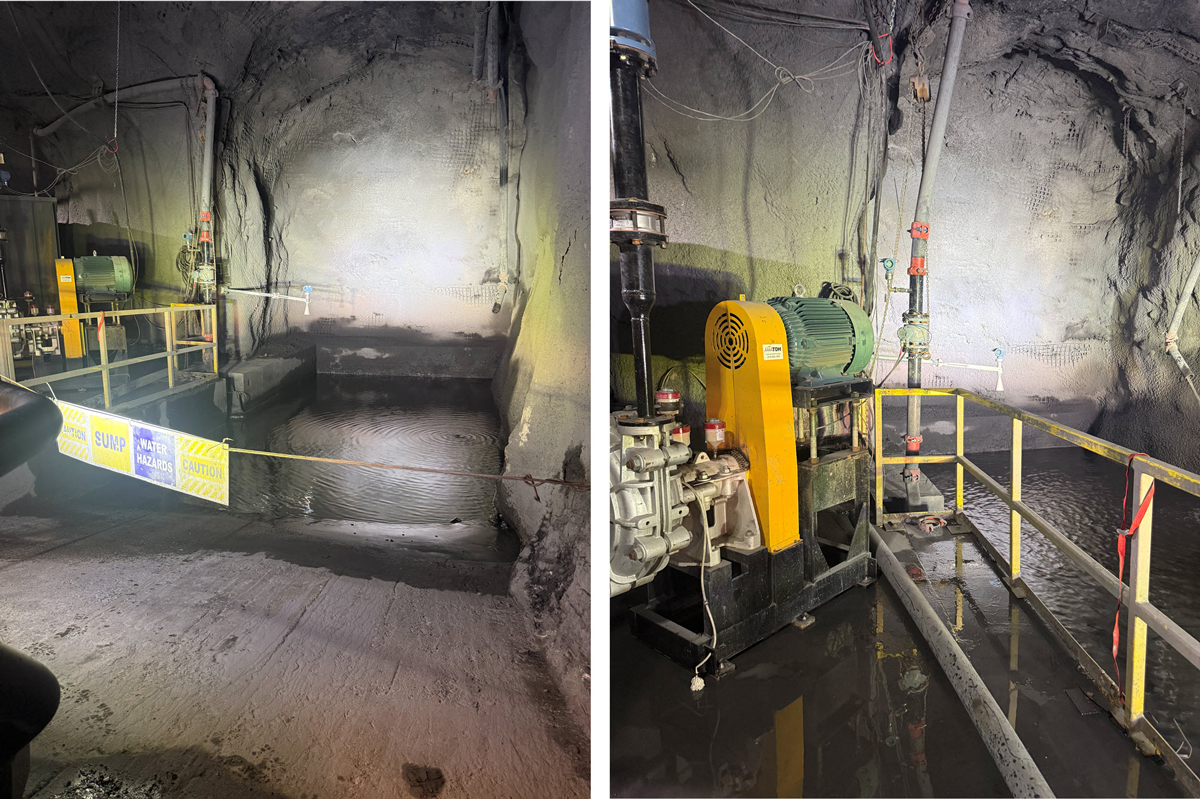

An underground sump pump station containing a motor, discharge piping, and staging platform with a water hazards barrier.

For decades, sump control in mines followed the same formula: a concrete pit cut into the floor, a few pumps wired to float switches, and a tank with agitators to keep sediment from settling and clogging pumps. Starting from the lowest level, each station pushed water up only to the next level, then the process was repeated all the way to the surface. Generally, it worked, but only because operators were constantly checking it. When a pump failed or a float stuck, crews had to hike or drive down to restart it— sometimes through flooded levels.
Most of these systems had no remote visibility, no performance data, and no easy way to see a failure coming. The typical industry upgrade involved adding a large PLC panel—expensive, power-hungry, and difficult to maintain.

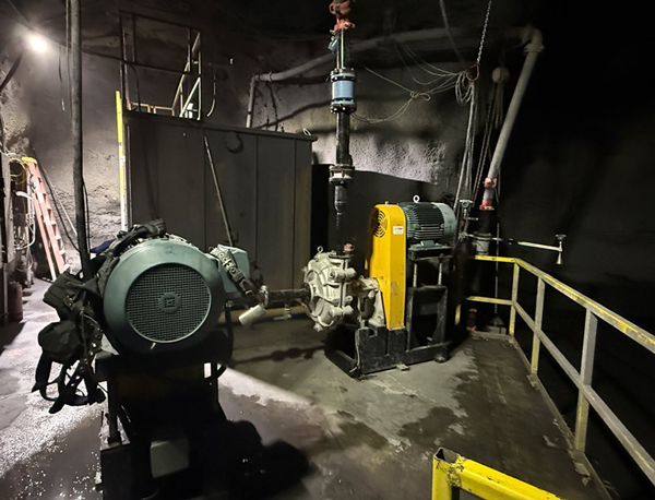

A sump pump motor and tank in an underground pump station

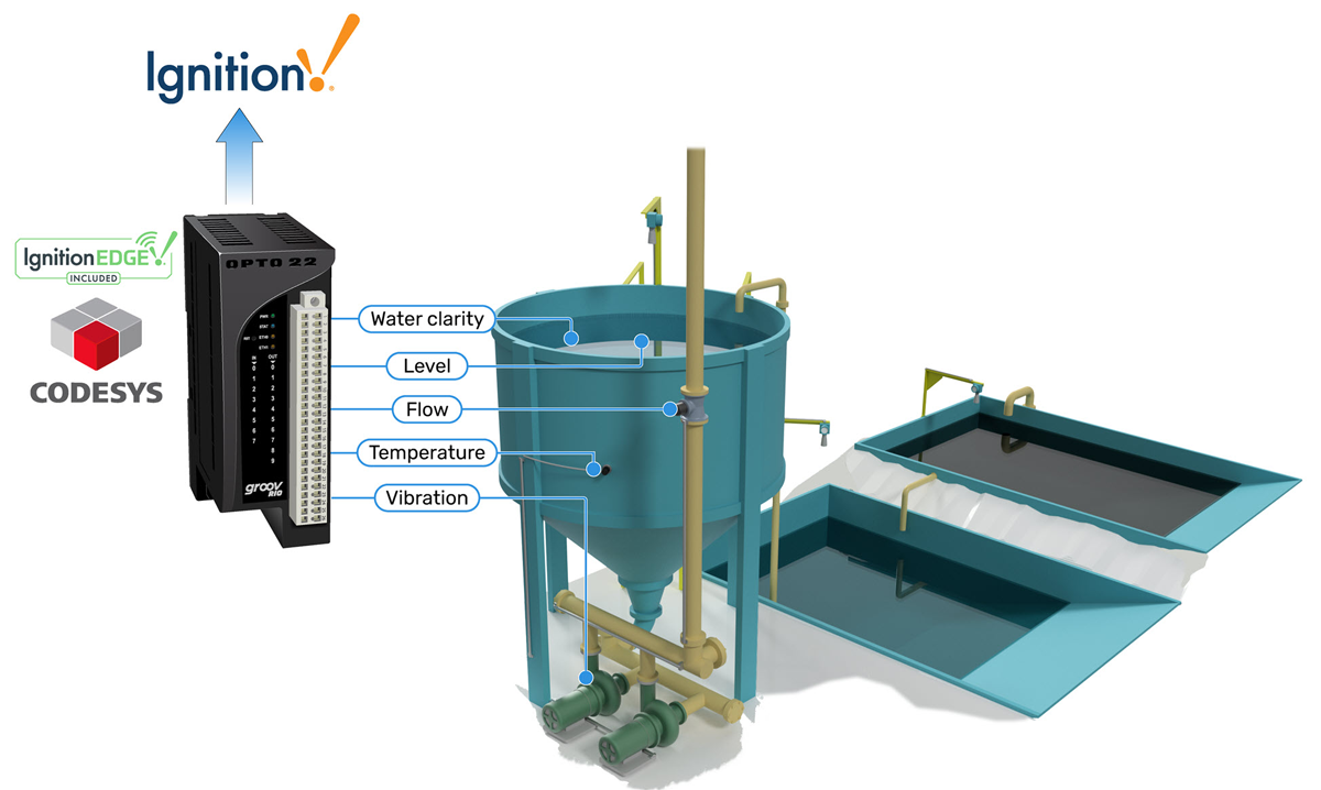

Surety’s team began by asking a simple question: what if the instruments themselves could deliver all the data we need—without racks of I/O cards?
Traditional analog wiring meant every pressure, flow, or temperature transmitter required its own pair of wires, terminal blocks, and I/O card channels. That kind of system quickly becomes costly and unmanageable. By shifting to digital communications, Surety could carry far more information on a fraction of the wiring.
They started in the lab with the idea of using a Moore Industries® HES HART-to-Ethernet Gateway™ to collect the critical utility and environmental data. The gateway collects data from up to 16 HART instruments and converts to Modbus/TCP, a standard, Ethernet-based, industrial protocol.
Each loop can carry multiple devices, so instead of wiring every sensor separately, transmitters for pressure, flow, temperature, and gas monitoring could all share a single pair of wires. This approach simplified design and installation while adding access to advanced diagnostics like sensor health and calibration status—features that aren’t available with standard analog signals.

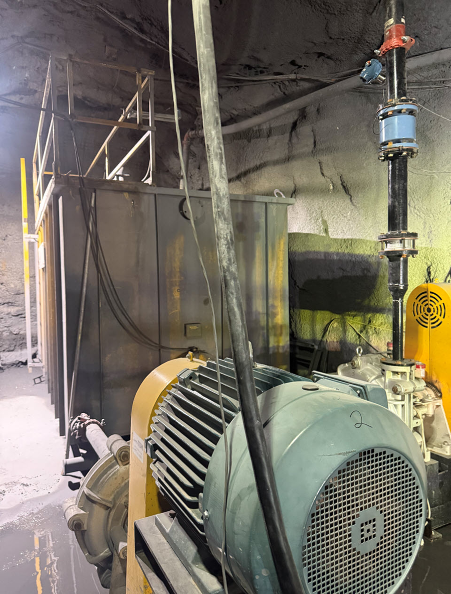

The upgraded underground sump pump station with dual slurry pumps and tank

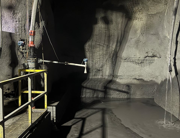

Discharge piping diagnostics collected through a pressure transmitter and ultrasonic level sensor over the sump

A diagram showing how the sump skid instrumentation provides the groov RIO the data needed for monitoring level, flow, clarity, temperature and vibration

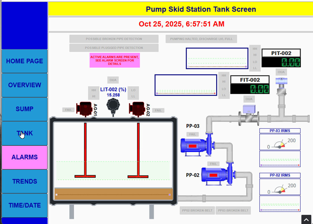

Surety had never deployed Ignition before, but it quickly proved to be the missing piece. With Ignition, the team could build screens, trend data, and manage alarms quickly and easily.
“Ignition with the historian and alarm manager was fantastic,” Raymond says. “It reduced our workload by weeks.”

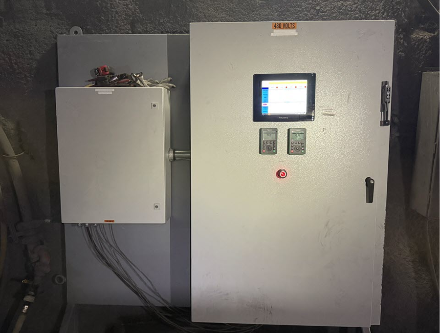

The new sump control panel runs Ignition for pump monitoring and control.

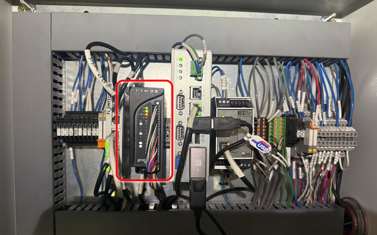

Inside the new sump control panel, a groov RIO is the bridge between the field devices and higher-level systems.

Even after meeting all the control and communication needs, Surety saw room to do more. And since the groov RIOs have ten total I/O points, Surety was able to use the remaining I/O channels for additional diagnostics—a rarity in typical panel designs.
“By freeing up the groov RIO’s built-in I/O—using just one channel for the E-stop—we suddenly had nine spare points to work with,” Raymond explains. “I used them for signals we never bother monitoring in a standard panel: the DC power supply health relay, Type II surge arrestor status, power filter health relay, and the contactor wear relay on the soft starter bypass contactors.”
Those extra points gave Surety and the mine operators a new layer of visibility into system health—data that’s typically ignored because of I/O cost or complexity. In fact, the finished panel ended up costing roughly 30–40% less than their previous design while delivering far more insight and reliability.
