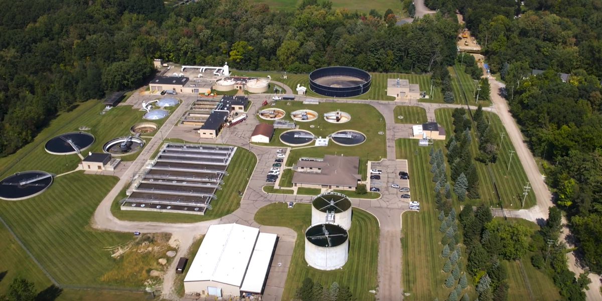

The Genesee County Drain Commissioner, Jeff Wright, Division of Water & Waste Services (GCDC-WWS) operates 180 remote sites across 600 square miles in the state of Michigan.

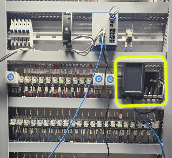

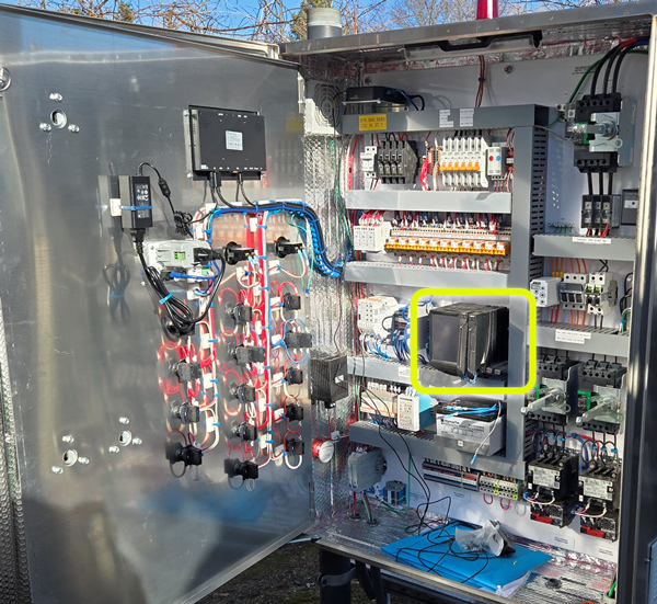

An outdoor control panel retrofitted with an
Opto 22 groov EPIC System
The Opto 22 groov EPIC system worked with existing PLC hardware.

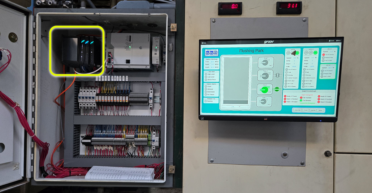

groov EPIC running local control and I/O, with groov View providing a live operator interface while data is shared via Sparkplug B MQTT.

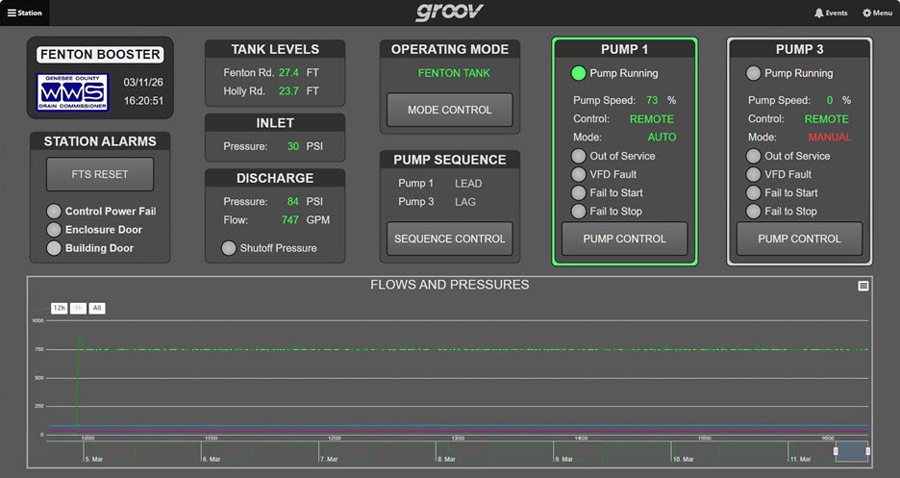

groov View HMI provides local pump monitoring.
