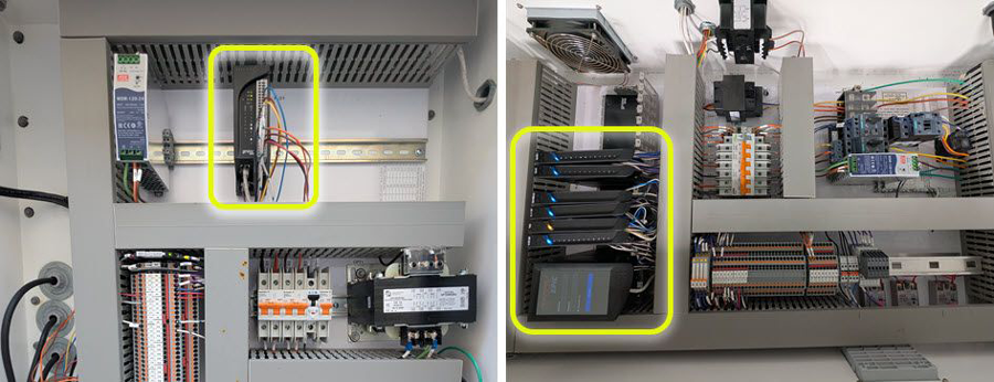

Each tower at the Pearl Pharma cultivation facility has its own panel to handle fans, pumps, and temperature sensors.

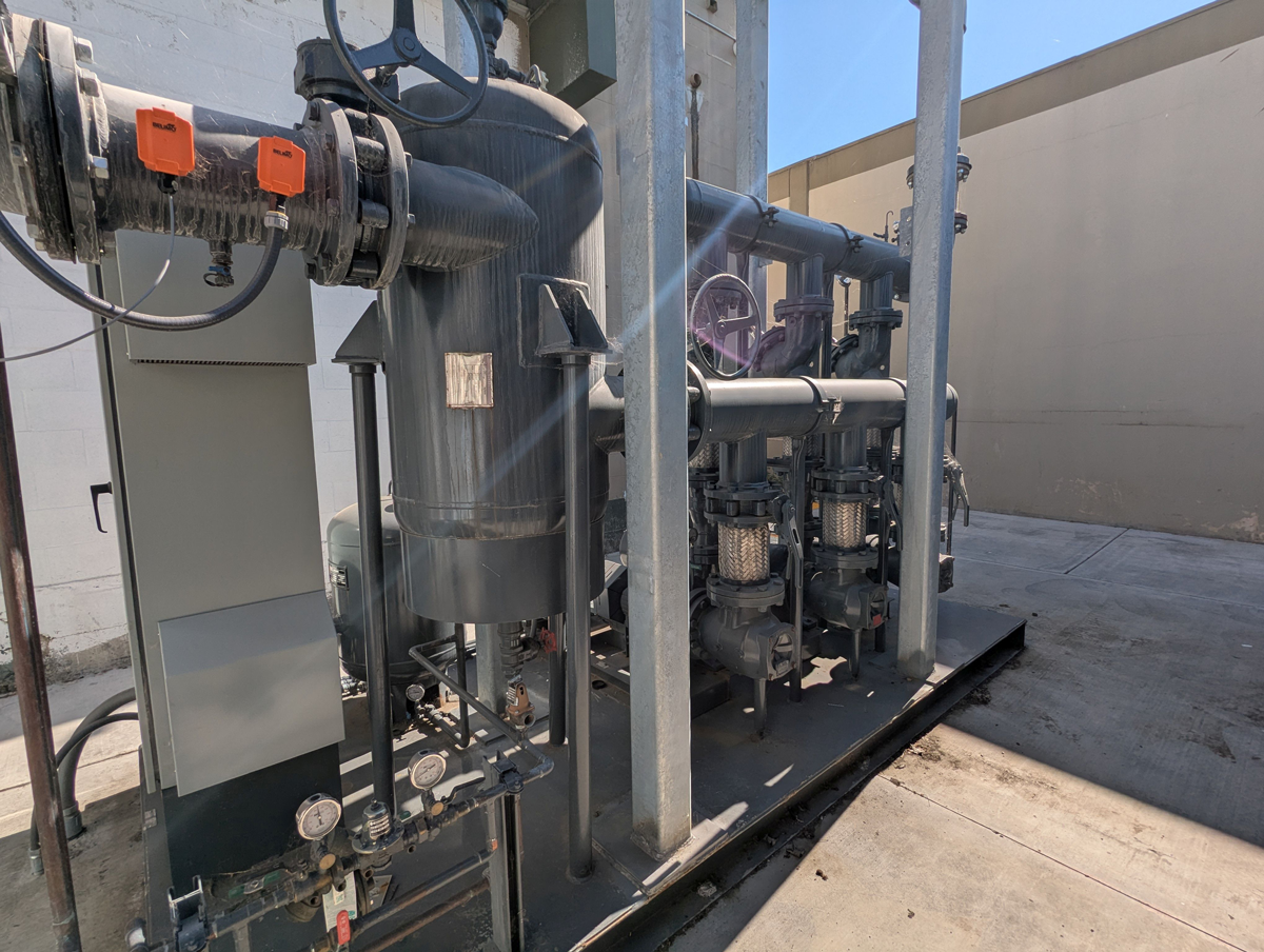

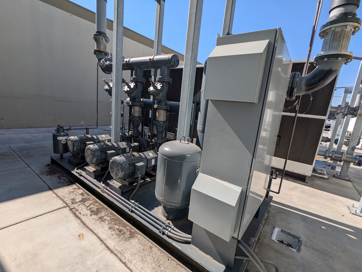

groov RIO keeps three main pumps, with a local control cabinet, running in sequence.
The pump station circulates cooled water through the HVAC loop.

groov RIO connects to VFDs, relays, and sensors—everything needed to run the fans and pumps—while the groov EPIC handles the logic.

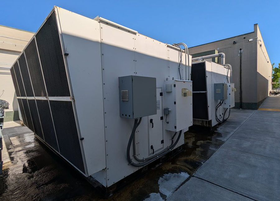

Once the room controllers were in place, Pearl extended the system to cover more of their facility, specifically large, outdoor, evaporative cooling towers that provide tempered water to support the water-cooled HVAC units.
Pearl outfitted each tower with a groov RIO edge I/O module to handle a small set of I/O: supply and return water temperature, outside air temperature and humidity, and control of the water wall pumps.
The RIOs also manage a set of six 7.5 hp fans. Using PID loops, they monitor water temperature and adjust fan speed through variable frequency drives to keep the temperature within the target range, typically between 90 and 92°F.
Pearl uses an EPIC inside the facility to coordinate actions with the outdoor RIOs, but in the event of a network issue or power outage, each RIO fails over to its own local logic using Node-RED. That local autonomy helps maintain cooling performance even if part of the system is temporarily offline.
