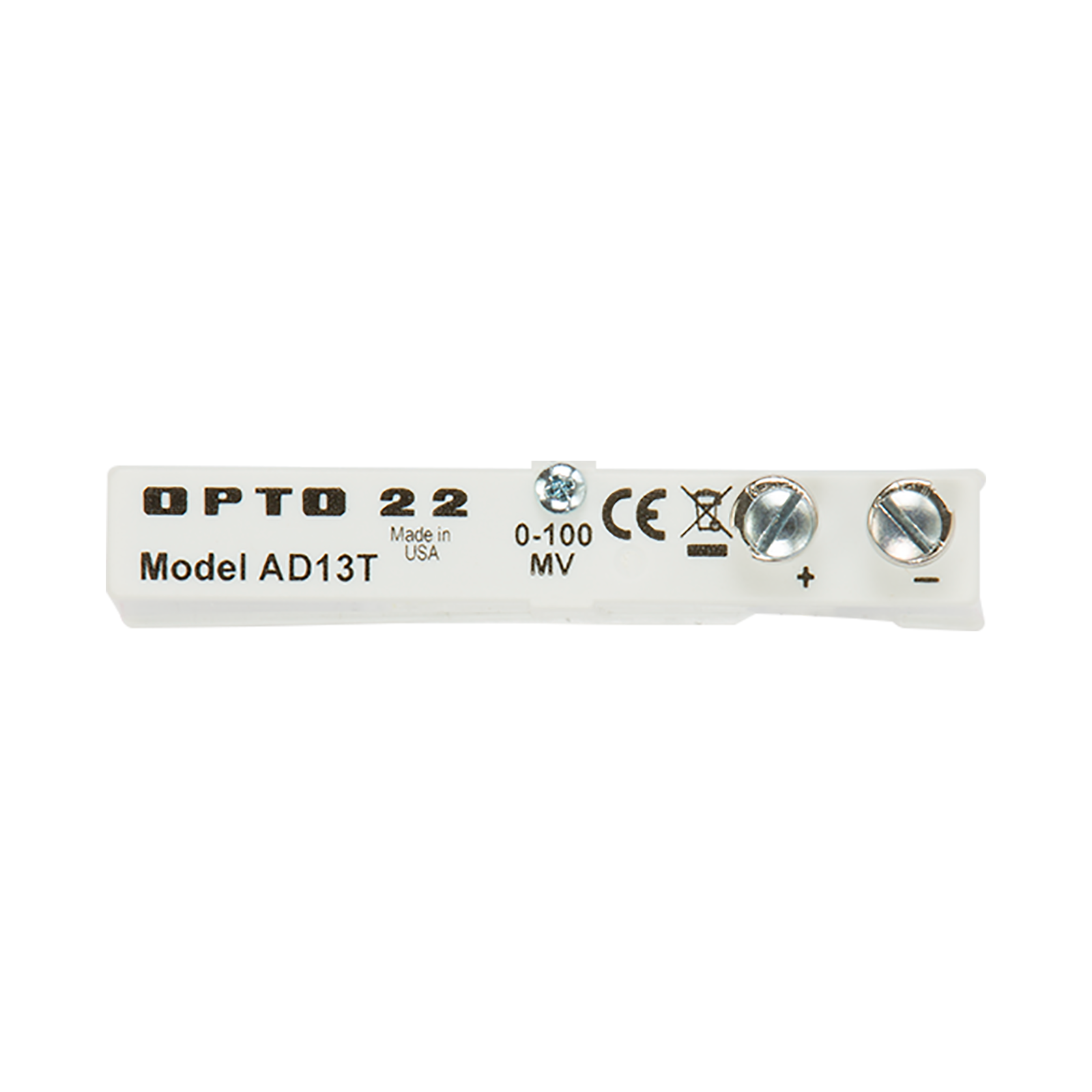

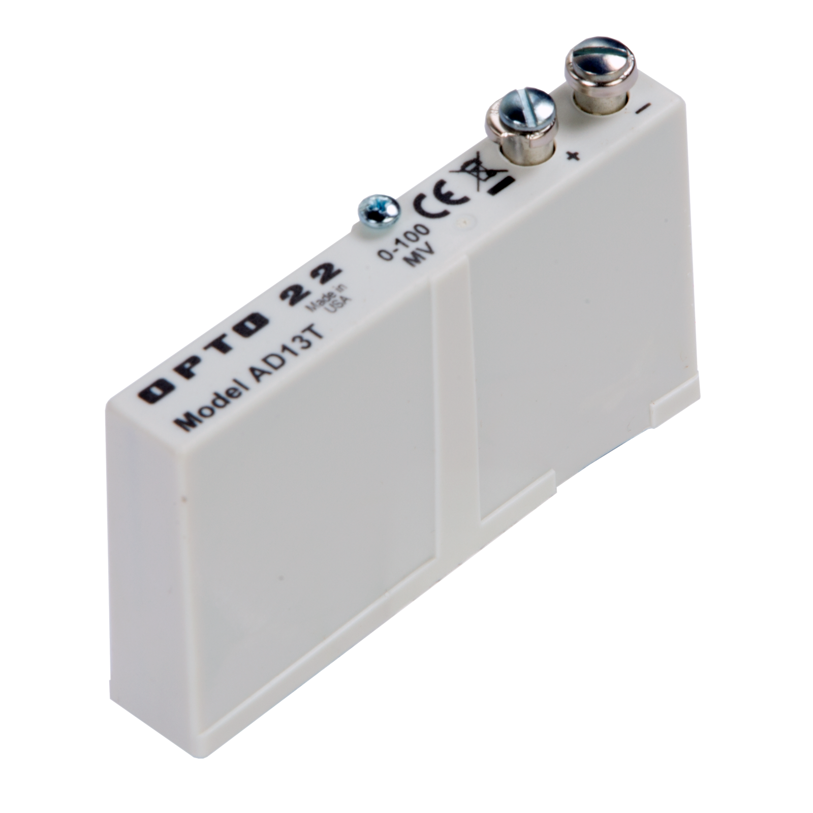

G1 0 to 100 mV Analog Input, Isolated
The AD13T analog input module provides a single channel of optically isolated and channel-to-channel isolated voltage-to-digital conversion. Nominal voltage input is 0 to 100 mV. The module's 4,000 Vrms channel-to-channel isolation eliminates ground loop problems.
This module mounts on a G1 analog mounting rack, for example the PB16AH.
