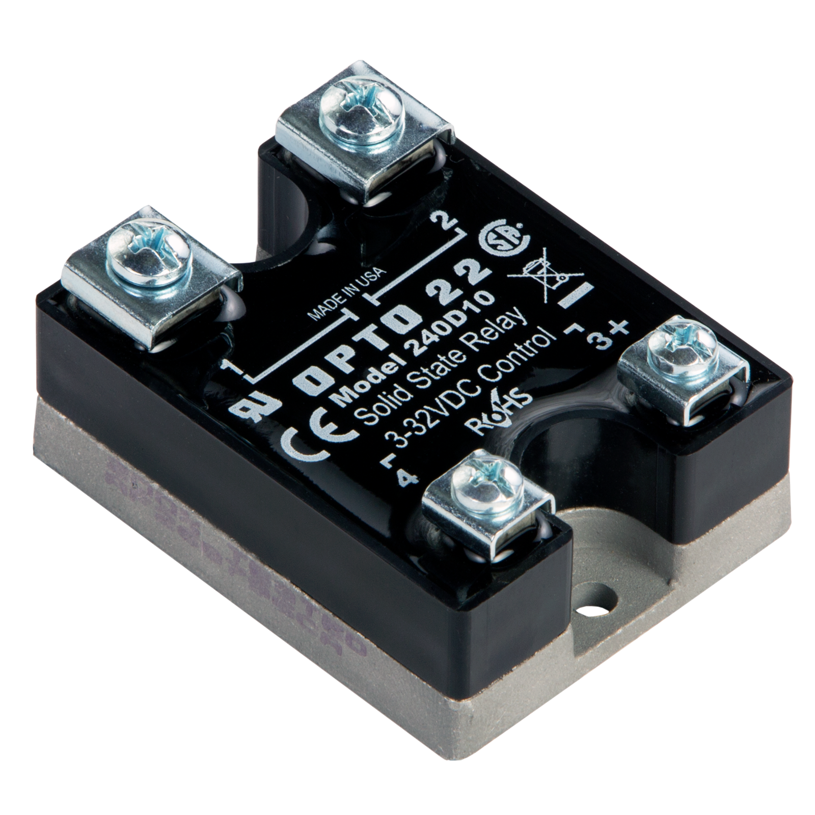

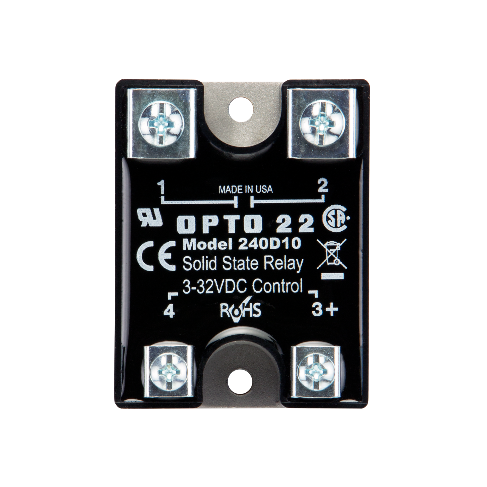

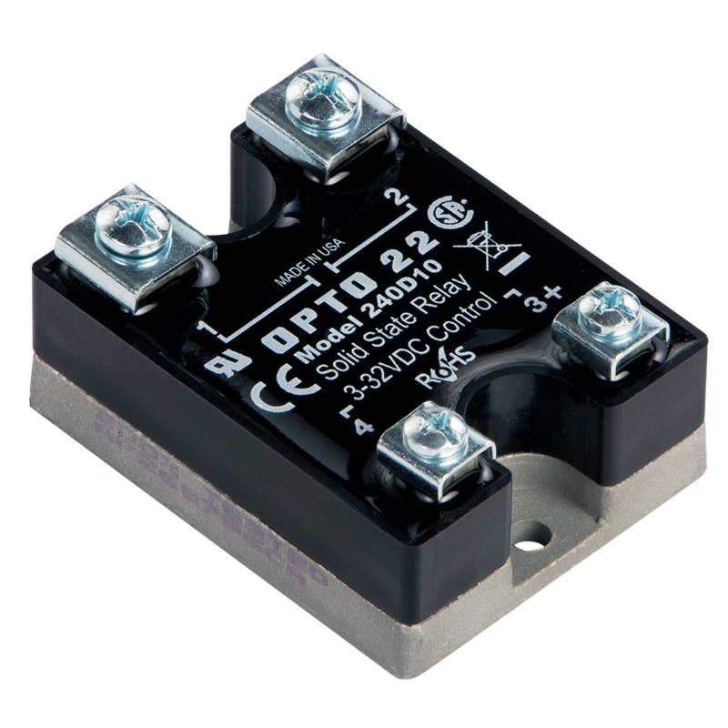

240 VAC, 10 Amp, DC Control Solid State Relay (SSR)
The 240D10 is a DC-controlled Power Series relay that switches 240 VAC at up to 10 A.
NOTE: We do not recommend mounting the terminal side of the SSR to a flat PCB (printed circuit board) or other flat surface, because there may be some variation in terminal height from one terminal to another and from one SSR to another. Use the MP or P series SSRs for PCB mounting.
